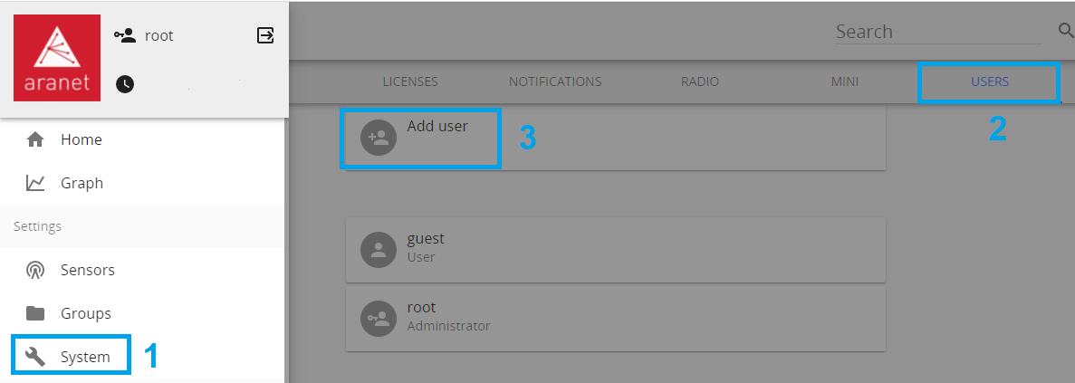

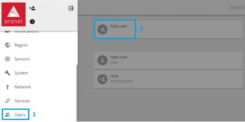

If it is necessary to send notifications (both e-mail and/or SMS) to multiple recipients, then individual user accounts in the Aranet PRO base station should be created for each necessary phone number and/or e-mail address in System -->USERS section:

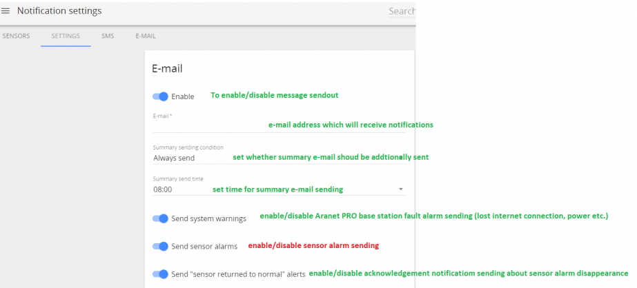

And then with each user account You need to login to Aranet PRO base station graphical interface and create individual e-mail and/or SMS configuration in System --> NOTIFICATIONS --> SETTINGS section:

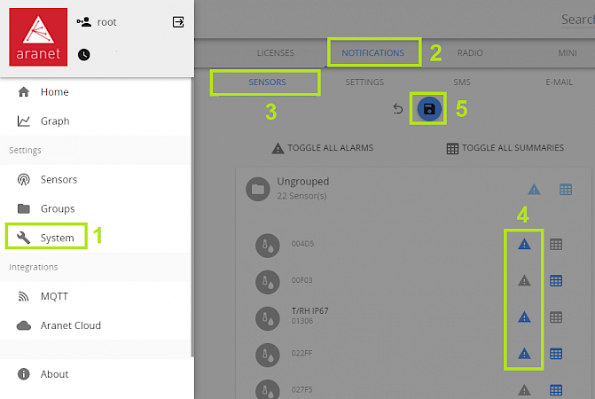

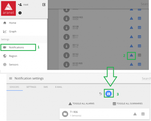

After e-mail and SMS configuration, please check section System --> NOTIFICATIONS --> SENSORS, so that sensor threshold alarm sending is also enabled for the necessary sensors. If notifications are enabled for the sensor, then the alarm icon for the sensor will be colored blue.
If the settings have been changed, then please do not forget to save them by pressing the appropriate button:
