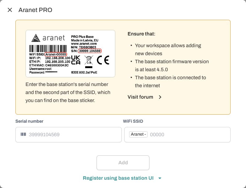

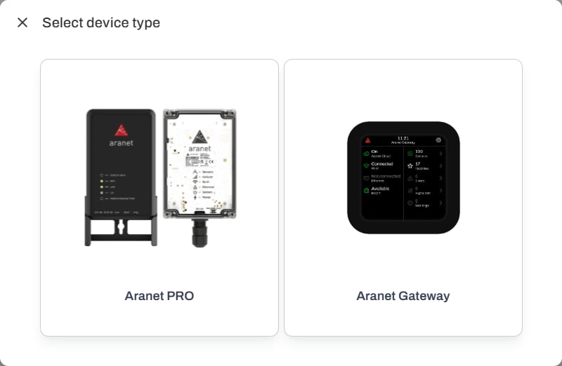

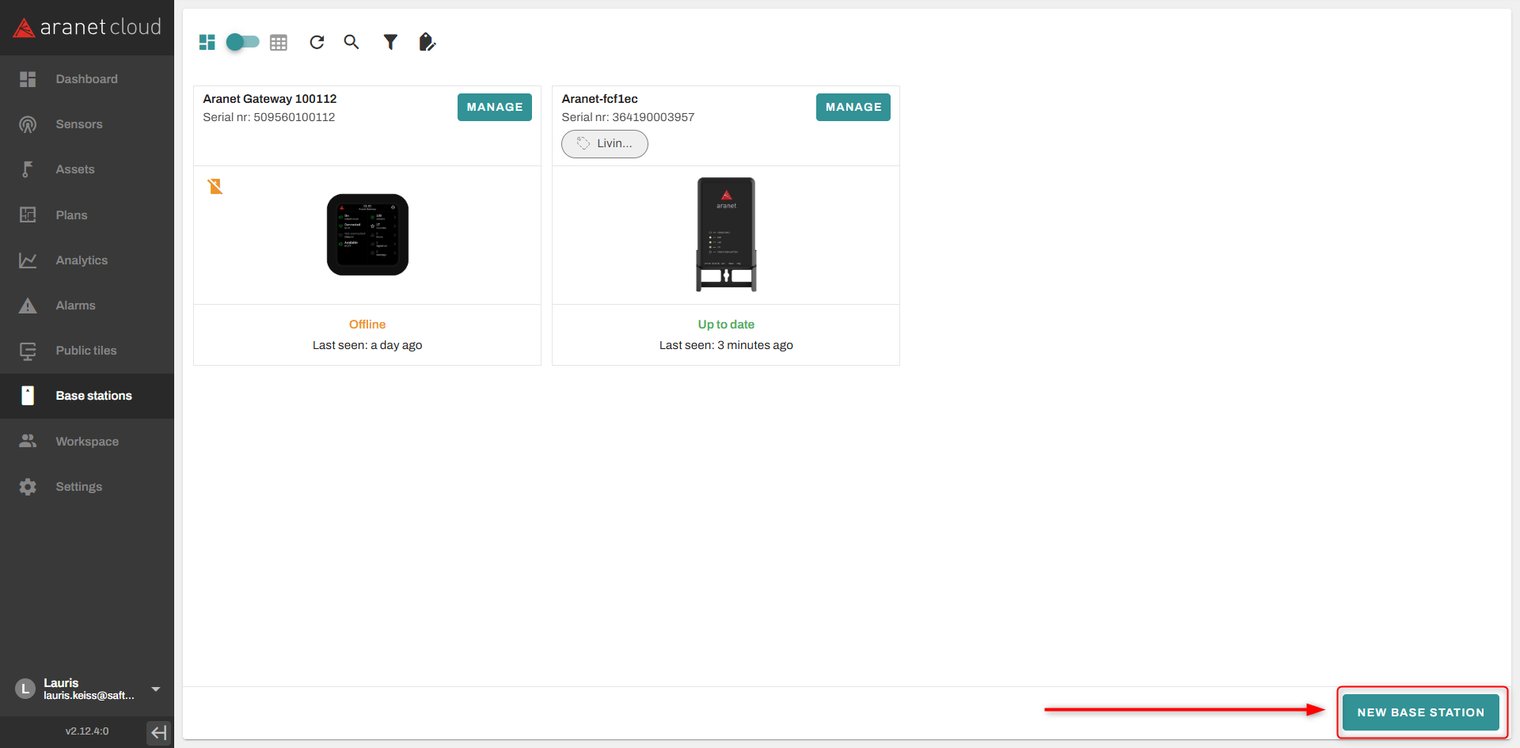

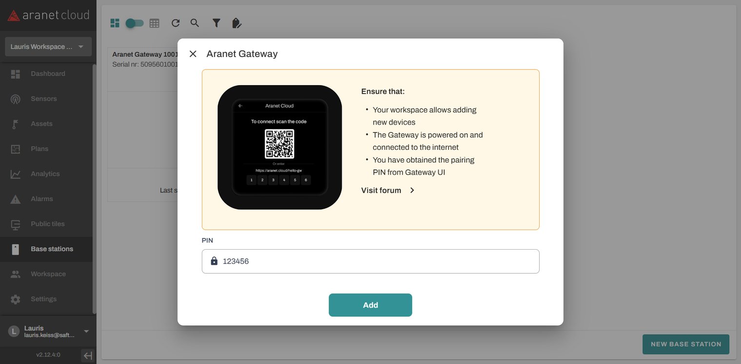

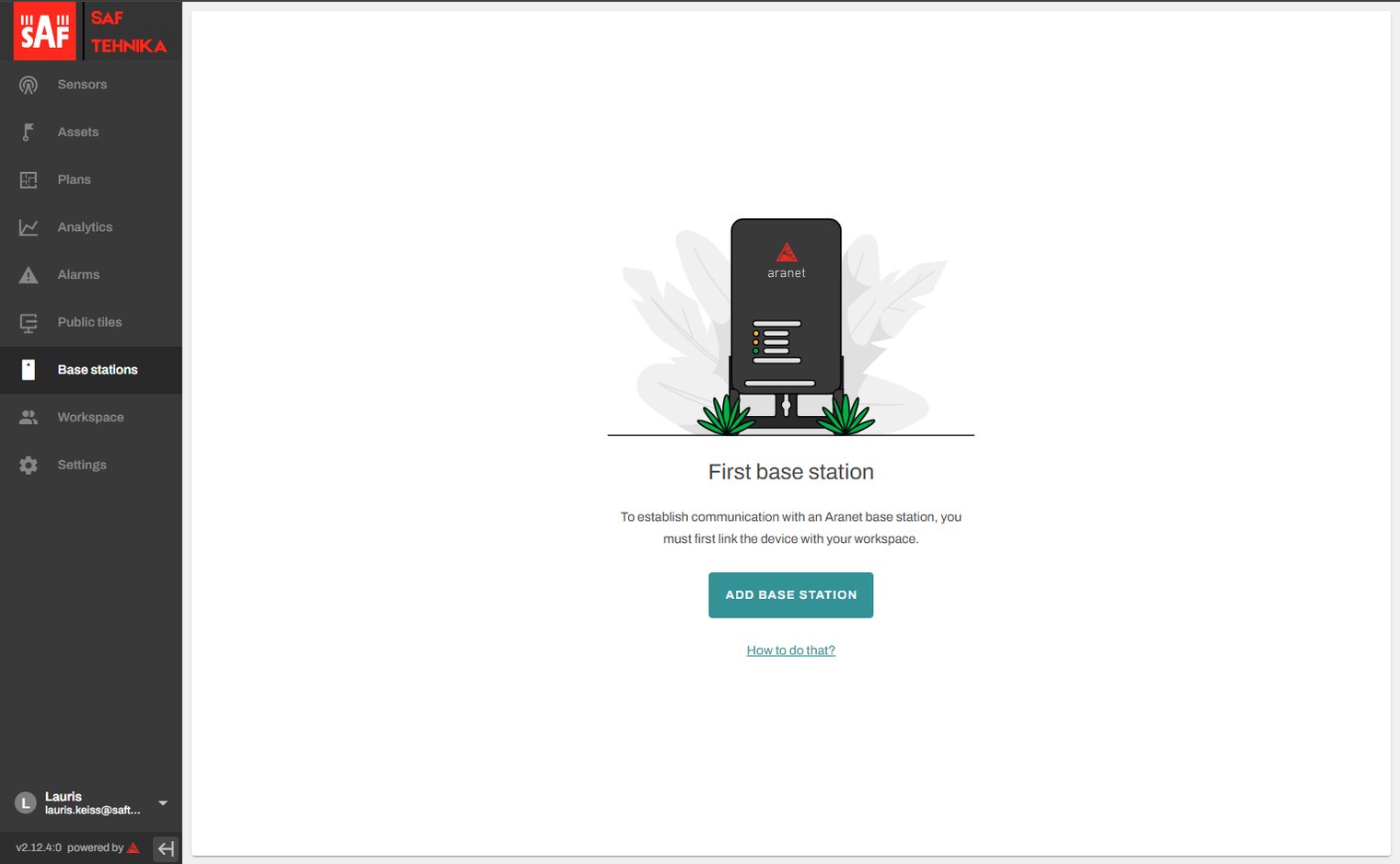

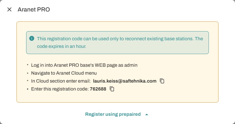

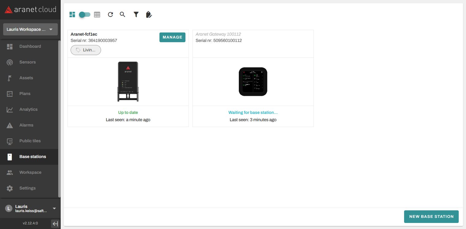

If you just created a new Workspace, go to Base stations and press ADD BASE STATION button:
Please NOTE, Aranet Gateway Pro or Aranet Pro base can be registered to the TRIAL workspace only once! You can not register the same Aranet Gateway Pro or Aranet Pro base to another Trial workspace.
For more information, please refer to another topic: Connect Base Station

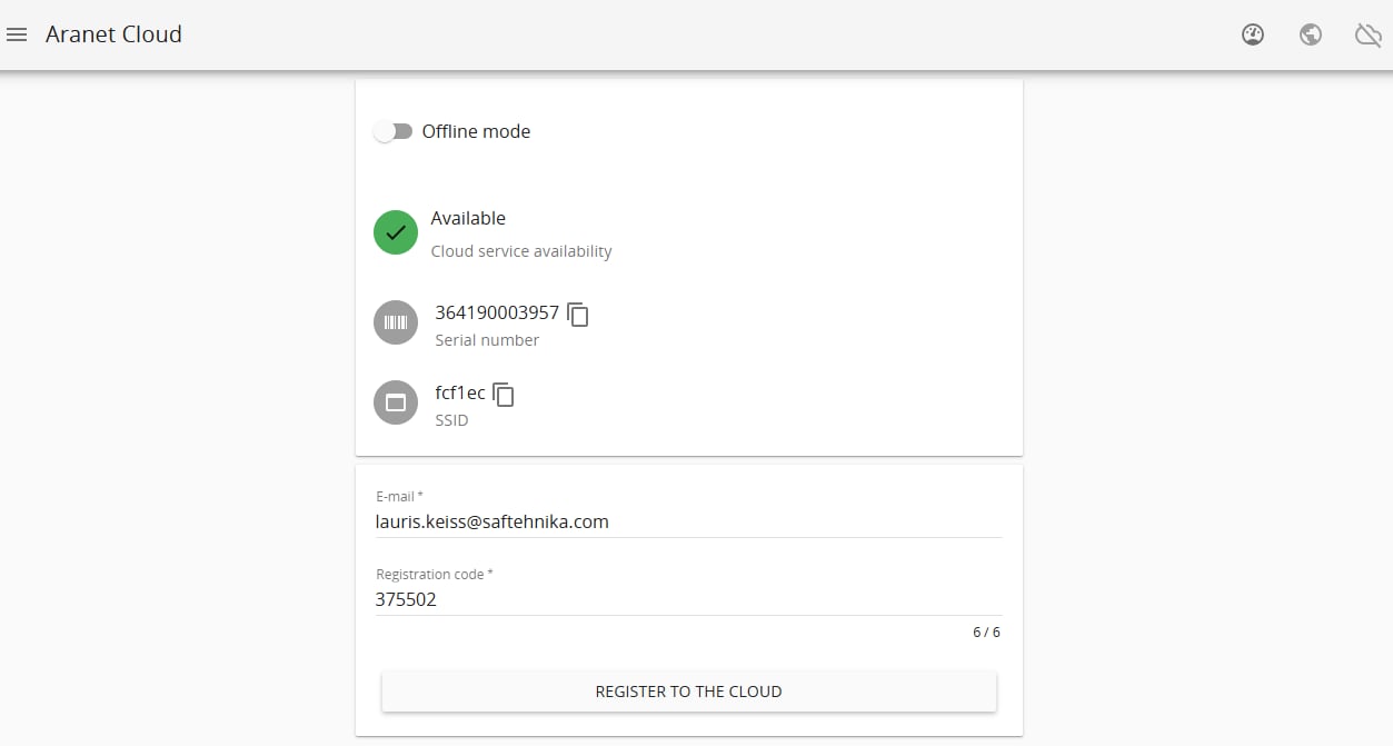

When registration code is created on the Aranet Cloud system side, then the next user must log in to Aranet PRO base station WEB graphical interface, go to the Aranet Cloud section, and here enter in appropriate fields the same e-mail and registration code as prompted in Aranet Cloud message. Then the user must click the button REGISTER TO THE CLOUD:
ernests
Posted: 04.01.2023 14:49
Link in ProBase sensor hub UI:
http://PROBASE_IP/#!/integrations/cloud
